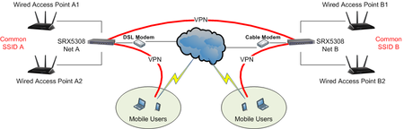

Wired AP - SRX5308 - Internet - SRX5308 - Wired AP
I am planning a complete redesign for the networks of two places and I would appreciate your thoughts or recommendations for devices. See the concept in the image. It seems that the SSL VPN will...

I have one last question. Can I implement "ensamble" with WAC720 or WAC730 connecting them to the same SRX5308? (without connecting the two WAC7x0 together)

Ensemble is centralized management, which means you can manage both APs in a single UI. If you want to manage them separately then you'll just have to put them on standalone mode. When on ensemble the AP belongs to a group, this does not mean that the two APs depend on each other. They are connected, yes, but because they are managed by a single UI. It is not like, being used as a wireless bridge or a repeater.
