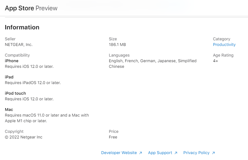

2) My Mac Book Pro can download the app however I read it is only for iPhones and iPads. When I attempt to start the app on a MacBook I receive a notification that my device is jailbroken or rooted. It is a 2021 Mac Book Pro. I have not touched it. I would not know how. I am assuming there is no application for the Mac Book Pro.

We understand Apple tried to extend the App usability by adding some iOS runtime environments to macOS 11.0 or later and a Mac with Apple M1 chip or later. Not a secret, this extension was done kind of silent, without further interop tests by Apple. Apple believed all app developers go and update all apps to support the functionality also on the M1 Mac. Could happen that certain code in the Apps (in place to prohibit the app to be operated on rooted or otherwise abused mobiles) can show such messages. Don't know anything beyond this...
Everything not a problem considering Netgear Insight can be perfectly managed using the Web portal on https://insight.netgear.com/
