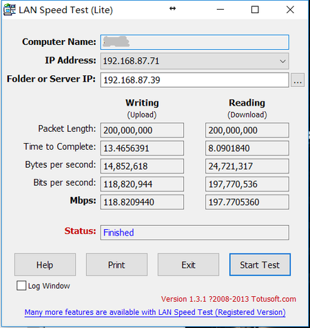

SoOK, I have done a bunch of tests and now I have a broad idea of what went wrong.
Now the two test PCs are all connected to WAC's switch, it didn't help.
I updated the driver for my Laptop and it seems to improve the upload rate to around 200Mbps so now both Uplink and Downlink have the same bottleneck.
The wireless rate is confirmed to be 866 during the iperf3 test:
And the results from iperf3 test are the same as the ones from LST:
And if I try a duplex test:
they all show that there is something limiting the rate to 200Mbps
So then I tried a upload test with multiple threads and the result is interesting:
So it appears to be a bottleneck within windows? Where the speed of each thread is limited to 200?
