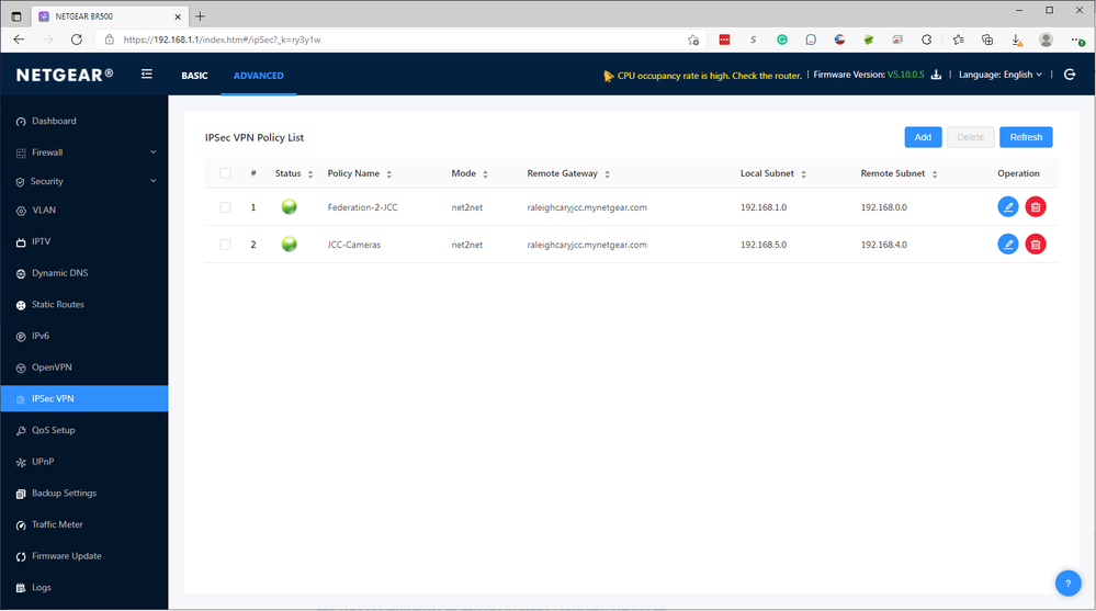

I've created the IPSec VPN Rules on each router, maping 0.0 = 1.0 and 4.0 = 5.0
Netgear Insight shows a 'connected' state for each rule.
Every 4-5 minutes I see a log entry in the BR500:
[IPSec VPN] CHILD_SA conn1 established with SPIs c50f0ea7_i cf3d1269_o, Monday, September 06, 2021 10:01:17
[IPSec VPN] CHILD_SA conn0 established with SPIs cefe13b8_i c173cb8a_o, Monday, September 06, 2021 10:01:17
[IPSec VPN] IKE_SA conn0[1] established between 172.2.200.58==24.163.52.97, Monday, September 06, 2021 10:01:17
[IPSec VPN] initiating IKE_SA conn0[1] to 24.163.52.97, Monday, September 06, 2021 10:01:17
[Internet connected] IP address: 172.2.200.58, Monday, September 06, 2021 10:01:12

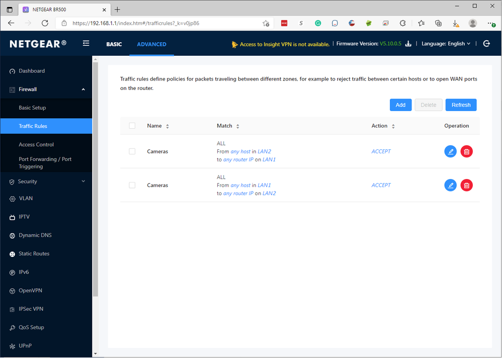

The firewall on each router allows the two VLANS to communication

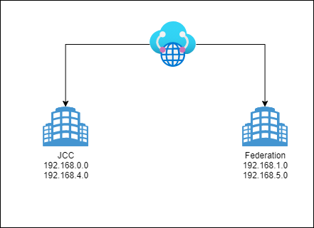

Topology:

Update: I revised the IPSec config for the Cameras to route 192.168.4.0 to 192.168.1.0
Briefly, I was able to ping the device 192.168.4.10 and then the IPSec connection reset and the ping went back to 'request timeout'. Something in the IPSec config is dropping the connection and after 5 minutes it reconnects.Any ideas on this?

At the location Federation, I have only 1 device. It's a WAC540 access point.
The location JCC has 35 devices and 4 VLANS.
The logs are just what is shown above.
