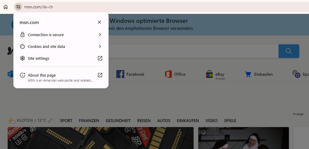

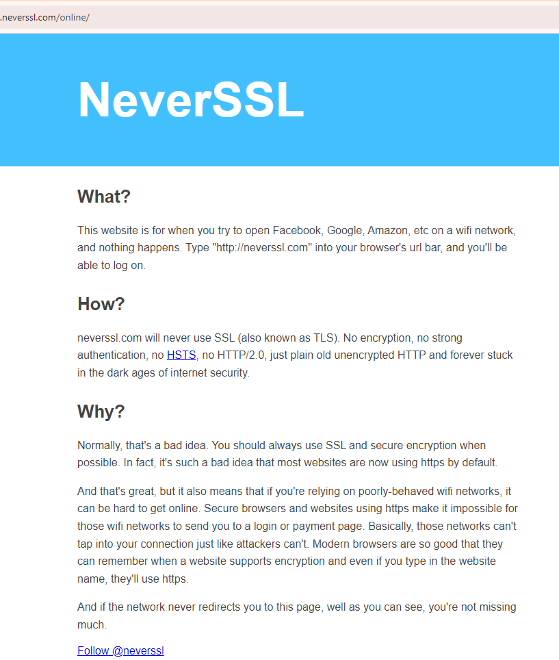

Not sure what hnagaraju expects from letting the OP try http ... considering msn.com does almost certainly force a https redirect (https and localized site) anyway?
Much better would be using http://neverssl.com/
