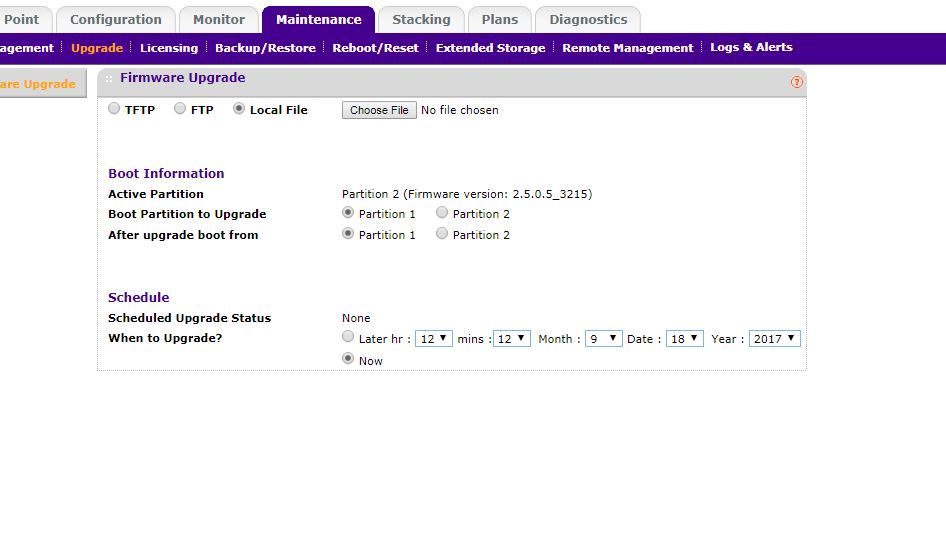

      One more question relating to the upgrade:  I notice that the controller has 2 boot partitions.  I assume this is so a user can boot to the other partition if there are any problems.
      Our controller displays that partition 2 is active and running Firmware version: 2.5.0.5_3215 but no information on partition 1 is displayed.
      What is the best practice for upgrading?  Should I use the active partition 2 or leave it as a backup?  Is there any way of seeing what firmware is on partition1 which isn't in use?

        You may use partition 2 since its the current active partition and proceed with the firmware upgrade.
        There is no option to check what is the current firmware version on partition 1 unless, it is activated.  For me, I suggest not to activate partition 1 yet because we do not know the current firmware version stored in it.  It might be a lower version of the firmware or it could be there is no firmware version stored in it. However, we could select partition 1 to which the new firmware to be saved then activate it.
