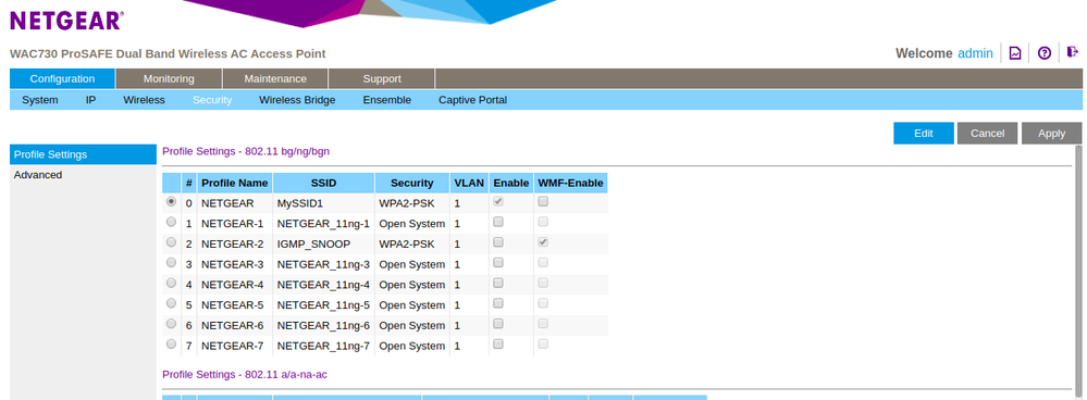

Success! Keeping WMF disabled allows pywemo discovery to work every time.
So from the config example I see a separate SSID for IGMP_Snoop with WMF enabled. If I need IGMP on the WAC720 in the future I will setup a separate SSID.
Thanks so much.
