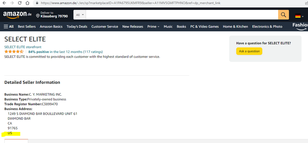

    In your case it's even worse: It appears you bought from Amazon Germany (double check), or have you bought from another seller offering on Amazon eg. on Amazon Marketplace, some even making use of Amazon warehouse and shipping, or shipping from other warehouses.
    The technical background is simple (except for Amazon - they are ignorant!): Wireless devices sold in North America, or specifically to the US, must follow the FCC regulatory. This requires that there is no way for the user to configure the equipment for using bands, channels, and power not permitted. This is why the customer can only select U.S. and Canada on the devices intended to be sold in North America.

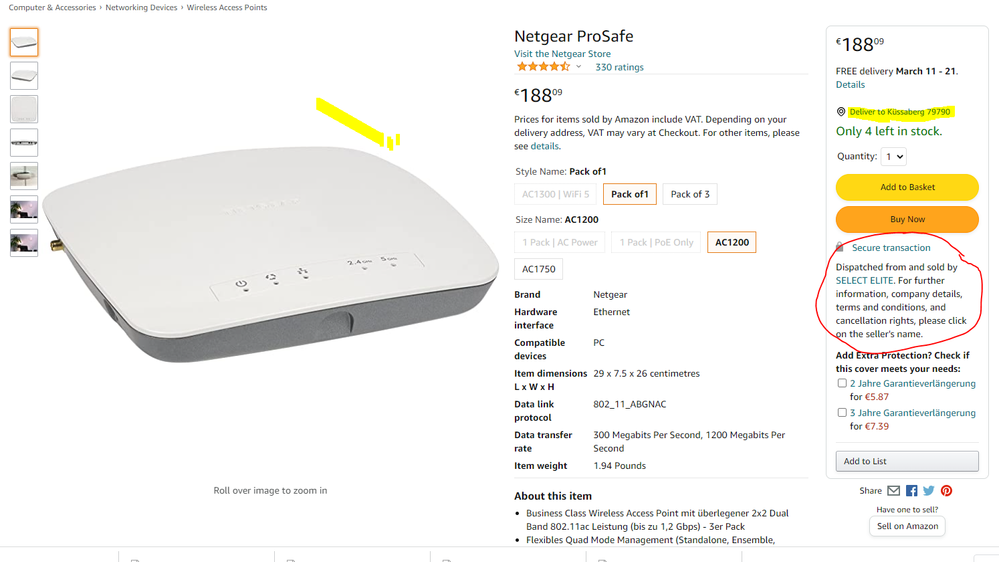

      Hi, thanks for your replies.
      I checked the amazon site. It’s exactly the same you posted in your screenshots with "Select Elite" as seller. So damn I didn’t know about the NAS thing.. also I would think about Network Attached Storage (NAS) features in Germany if I read this somewhere. :S
        I find it not an acceptable business practice offering and selling or offering illegal hardware for export, regardless if it's Amazon US, Amazon Germany, or a related marketplace seller.
