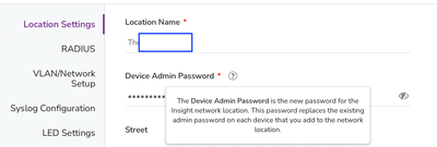

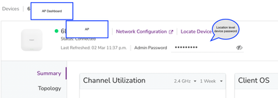

Netgear Team- abacqdghfthMar 02, 2023Guide
If the WAX610 are managed by Insight. Then the Location's "Device admin password" needs to be used on WAX610 local UI.
you can find out the password by logging into Insight account and going to the location.
