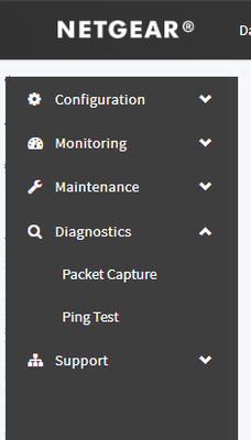

BrianL I don't seem to have that option on my device...

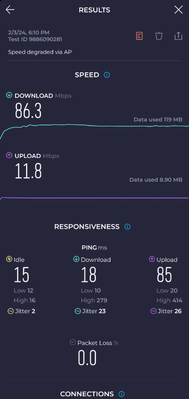

When I run Speedtest from a wired PC hooked in to the same switch as the AP, I get full speed:
vs my phone when 2ft from the AP
Or a desktop over wireless with a wall between
After a reboot both of those wireless devices get full 500+ speed.
Appears the Speed Test no longer available on the recent WAX6xx (have not compared the WAC5xx) builds, neither on the local Web UI, nor on Insight.
