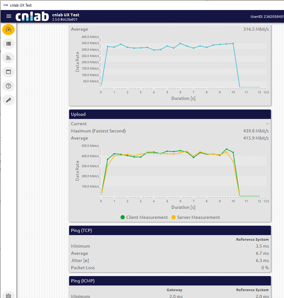

In reality, the WX214 does easily exceed the up- and download speed with reasonable wireless client.
In a test scenario, with other 5 GHz AP active on air and in use, the test client here does establish a weak 649/600 (Mbps) PHY link speed only.
Key reason is because the WX214(v1) does only offer four 5 GHz channels which are heavily used here because we're benchmarking MLO these hours, so only 4 channels at 20 MHz nd the concurrent usage does not allow to reach the 1201/1201 Mbps the WX214 does easily reach typically.
Even at these low PHY link rates, the WAX214 does easily reach much more performance on a popular Swiss cloud test then the numbers you report. Some 750..850 are easily possible under good conditions with the WAX214 and an average Intel AX200 or better.
Said this: Netgear refuses to enhance the WAX214(v1) for supporting the DFS channels, at lest for the EU/CE regulatory domain
This makes the WX214v1 (or WAX218v1) not feasible for deploying more than a single AP in the same house or office.
