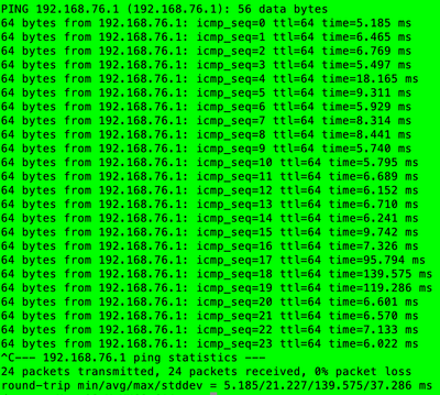

WAX214 AP ping Spikes on Internal Network, Why?
The WAX214 in question is running firmware 2.1.1.3.  The ping testing is on 5 GHz which is the default channel 36 and this channel cannot be changed:
If I connect the WAX214 ethernet cable directly to my MBP I see no such spikes so they are related to 5 GHz wireless.   Never had this problem with my old regular ASUS APs.  I am using VLAN feature.   The AP is connected to a GS305EPP switch.   How do I troubleshoot this?
Thanks!

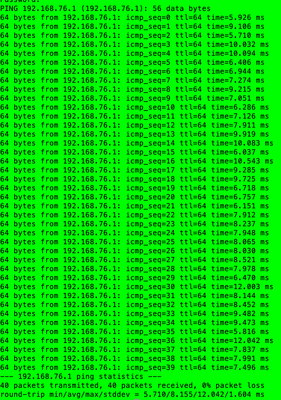

  • Fiddled with with WiFi Channel Configure.  Specified one channel for 5 GHz then went back to ALL (auto select).   Initially both APs were using Channel 36.   After fiddling with channels I set both back to All.   Now each AP is using a different Channel and large latency spike is no more.  Not sure why each AP didn't auto select a unique channel initially.
