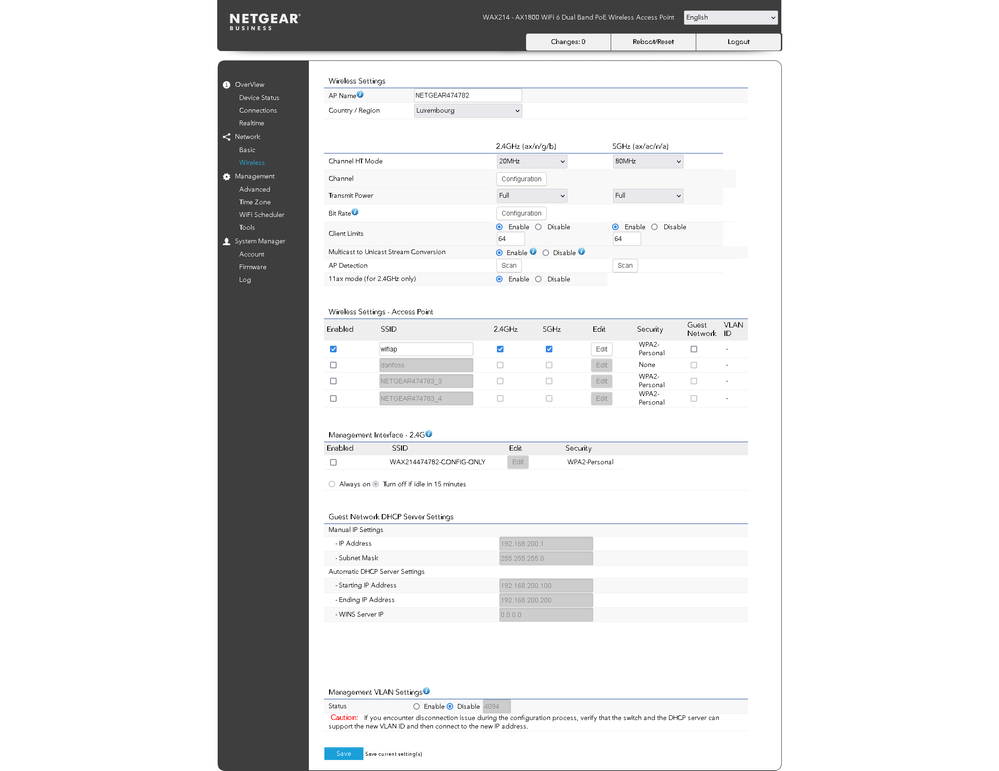

Just finished setup up a business access point, WAX214, upgraded the firmware to current latest, which is v 2.1.1.2.
I would like to lower the transmit power. The documentation says I can choose the rating in dB.
In the Web interface, I only see 3 choices: Full, Half and Quarter.
Why is this different from the documentation? I specifically ordered this model based on the description of the documentation.
How to lower the power to below a quarter?

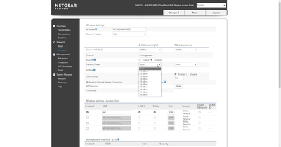

Welcome to the community!
Please disable Auto RF to be able to change the transmit power of the AP in dBm.
For your reference, kindly check the image below:
