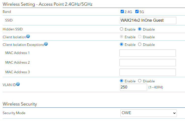

WAX214v1 had it implemented correctly... But, if the WAX214v2 is done anything like the WAX220 (very likely), then your Guest Network will be able to communicate with your internal network, such as logging to 192.168.1.1...
Translating this rant to laymen terms. Under some unknown conditions, it appears the controls for Client Isolation and the related Client Isolation Exceptions remain invisible. The Client Isolation does however work as designed if enabled. Guest devices (locally NATed from a private IP subnet - different from the classic wax214/218 design) will not be able to reach the local LAN subnet eg. like the ubiquitous 192.168.1.1 or 192.168.0.1 of many consumer routers in use behind the guest network.

L2 isolation feature exists on the WAX214v2, v1.0.2.2 or WAX220, v1.0.3.0 similar to the screenshot above), and works in my testing as expected. Not that I'm a Netgear voice or carrying such a hat. The real issue here seems to be the two controls are hidden in the Web browser under some conditions unknown to me.

Test was pretty straight forward - Plugged WAX214v1 in, connected to a Guest Network, tried to access router admin page and was denied. Plugged WAX220 in, connected to a Guest Network there, tried to access router admin page and was successful. Did the same thing but with toggling DHCP Snooping on/off on a GS308T switch. Not exactly sure why the WAX220 only works if I turn off DHCP Snooping, but maybe it's something to do with the Guest Network's DHCP server and L2 Isolation since that's the big difference between the WAX 214 and 220.
The WAX220's Client Isolation is working fine... the L2 Isolation is not, nor is even visible. I can absolutely connect to 192.168.1.1 with a Client connected to the Guest Network on the 220, but not the 214v1. Just tried it again as I posted this.
The original firmware for the WAX220 has the L2 Isolation option visible, but updating it to any other version removes it. Reverting back to the earliest version of the firmware posted on the Downloads page does not restore that option.

Amazing, being member of the WAX220 Beta Test community, and as an average unpaid idiot spending a lot of my spare time helping users here in the community, I can't provide another reply - because all the Beta units, and units I bought from Swiss Netgear retailers, paid with from my own hard earned money, ... do have the controls available, in my testing this works like a charm. Here on my WAX214v2 on v1.0.2.2 firmware:

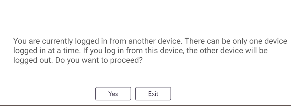

Hello WTomP
WTomP wrote:
... due to continued login problems, related in some part to having 2 devices logged in at the same time, but Netgear support are puzzled why.
Must admit that I don't have the full picture why Netgear decided to simplify the WAX214v2 and the WAX220 Web UI, getting rid of the ability to track the open admin changes, and limit the access to just one device resp. source LAN IP address, limiting the capabilities for no obvious reason when comparing to the WAX214 and the WAX218.
Based on the current v1.0.2.2 (WAX214v2) and the v1.0.3.0 (WAX220) firmware, both throw such an information if having admin sessions open from different source IP addresses...
In my testing, this works as it should, of confirming to logout the other sessions is enforced, and the local password login is granted.
Can you please a little bit iterate more what is confusing to you or your Netgear support case?
TIA
