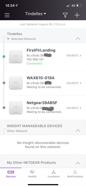

WAX610 extenders not connecting
Hi there - 3 x WAX610s have worked faultlessly since Nov 20, but in the past few days, despite no changes to the network, we've seen these devices disconnecting at random times. My plan was to factor...
redders123
Aug 07, 2021Tutor
Raghu davys Thanks for your help - the bizarre solution (as suggested by @davys) was to change the secondary DNS settings on the root device from the gateway (192.168.1.1) to 8.8.8.8. Once I'd done this I perfomed another reset on the WAX610 extenders then claimed them through the insight cloud interface - both extenders then connected and appear to be working fine.
