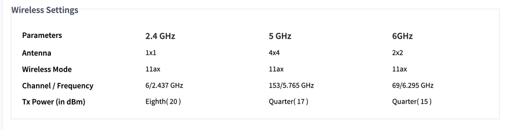

To Recreate and Work Around:
1. Set your power settings in Insight or the local management GUI. (I have one AP on Insight and one locally managed to be able to try this on both)
2. Set and confirm the power settings actually took, both Tx Power AND dBm (This is local GUI view):

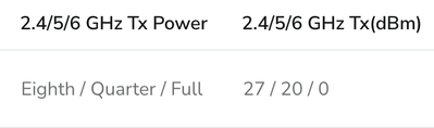

This is Insight view (under the Wireless tab, looking at the device profile:
3. Now reboot the APs and check again - the Tx Power is still set right, but the actual dBm delivered is wrong:

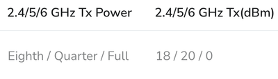

Insight View:
4. Change power for each antenna to something else (Eighth --> Half, Quarter --> Eighth, doesn't matter).

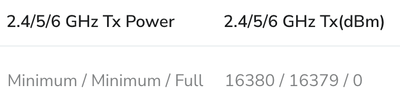

4a. This bothers me less, but if you set the power to "Minimum" you get a bogus number, with any other power setting you get something sane:

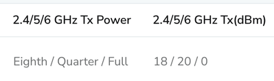

5. Apply and wait for the power to change in the GUI
6. Set power back to desired to get the TX power back to where you intended it.
7. Apply and wait, and it should be correct until the next power cycle.
