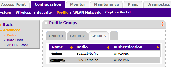

Sep 18, 2018Aspirant
I will take a look at the backup config later to remove anything I do not need to share. Here is basic idea though. 2 sites, 2 groups, WLANs assigned to different groups, APs in different groups, but both SSIDs are being advertised from both APs.

- RaghuHRSep 19, 2018NETGEAR Expert
Thanks JCC83 but that is not enough.
We need screen shots of all the 4 (Group2 and Group3) profiles.
- Configuration->Profile ->Group2 -> Edit
- Configuration-> Profile -> Group3 -> Edit
- Edit page will have all the ssid configuration and we need screen shots of the profile edit page.
If you can share the config back-up file for us to see how you have configured. You can modify passwords if you think it is security issue and share with us.
Thanks,
Raghu
- JCC83Sep 19, 2018Aspirant
The backup contains a lot of files and along with passwords there are also site names and addresses I rather not publish. Not that they actually matter as there is nothing happening at these sites, but I always work on need to know basis. If you can call out particual files you want I will scrub those extracted files and share.
