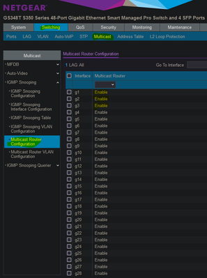

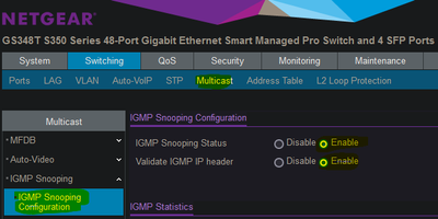

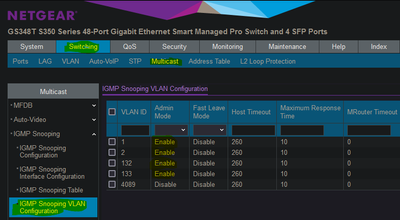

Configuring settings can have DHCPv6 packets forwarded
Enable IGMP snooping globally.
Enable IGMP snooping on the VLAN that DHCPv6 packets are forwarded.
Enable Multicast Router on the ports where DHCP server and clients are connected.See attached example.
Enable Multicast Router on the ports where DHCP server and clients are connected (in my case all 52 including ISP WAN)Check the MFDB Table for forwarding Interfaces and test IPv6 connectifity after fresh DHCP request:
