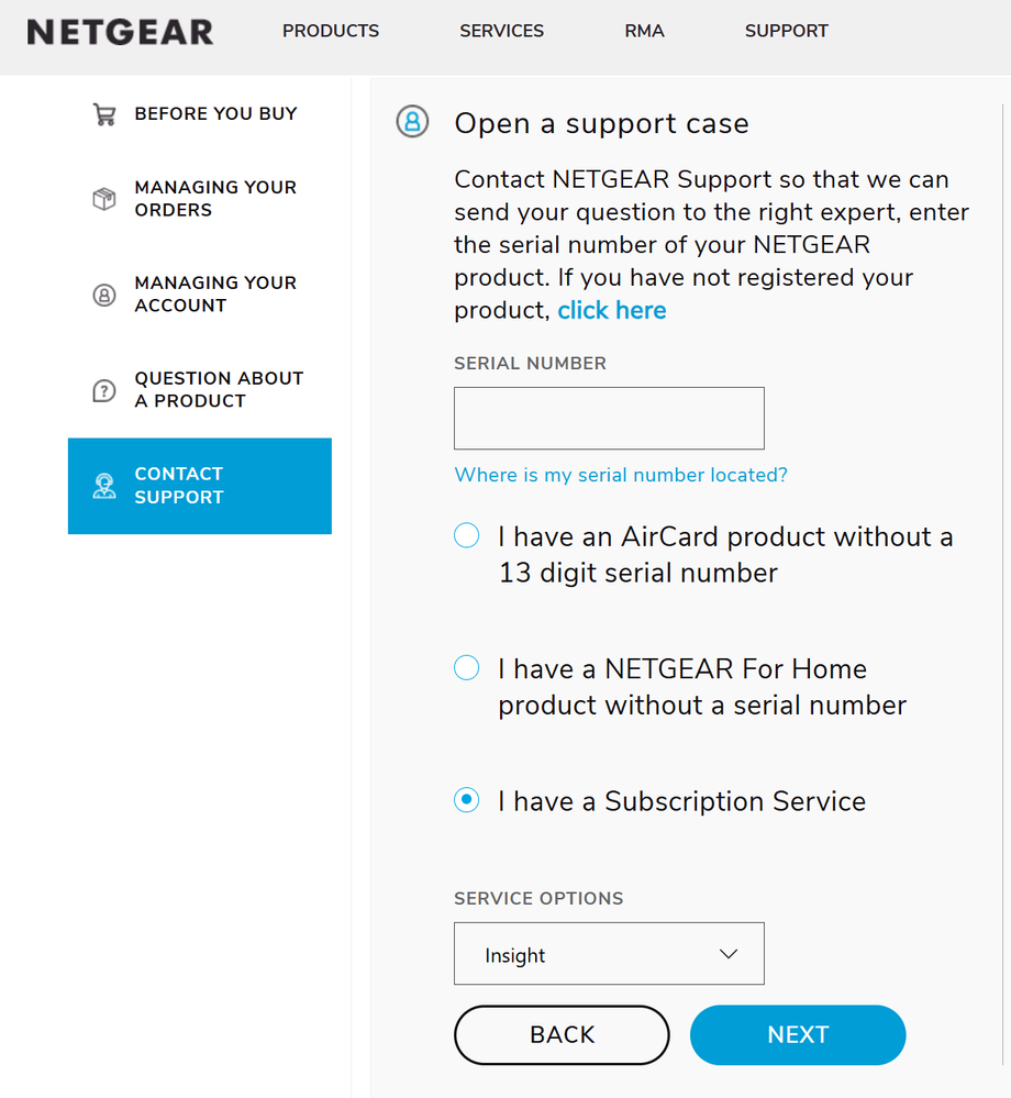

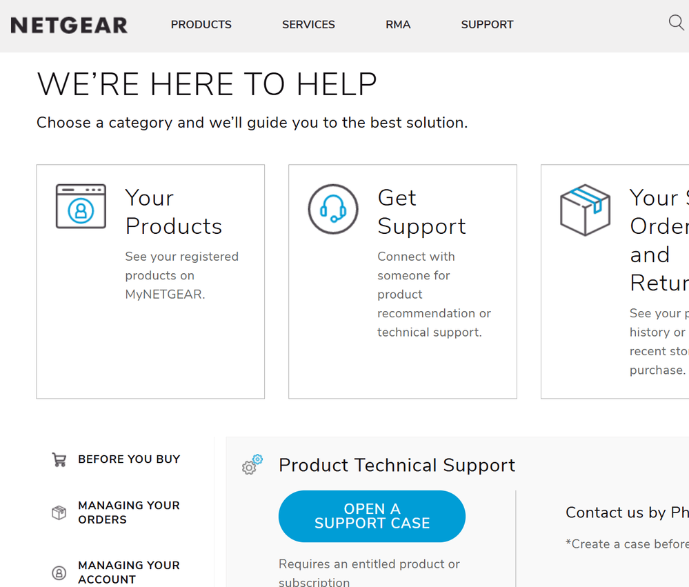

    Active Insight Subscriptions always include support.
    Head to https://my.netgear.com/support/contact.aspx (login inc case you are not...)
    Get Support -> Open a Support Case
    Select (x) I have a Subscription Service
    Select the Service Opions -> Insight
    Best way is then to Call Support (Chat is often overloaded).
    Provide a -brief- description...
