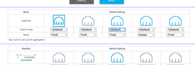

AX1800 SXR30 LAN port not working
Not sure if this is the correct forum to post this, but here goes. I have just acquired the Orbi Pro WiFi 6 Mini Dual-Band AX1800 system for use in my personal residence. Beefy to use for gaming and ...

Further information; I basically, unknowingly I might add, followed these instructions from Netgear.

Good to hear you got the issue resloved.
Orbi Pro wired ports are similar to a smart switch;
In general :
If you connect port an end device like security camera, Printer or Laptop to wired port. you can change the Mode to "access" mode and put it on the VLAN you need (VLAN1 is the default).
the end device gets the access.
If you are connecting the wired port to another switch and you want all VLAN(networks) to be available on the other switch too, then put the port to "Trunk" mode.
