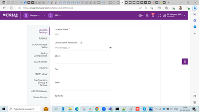

        There is a confusion. I'm not talking about "insight.netgear.com password".
        In insight you add devices to particular location say example Home or office or any name this location has customer information location name, Device admin password, address and wireless region like this. Please refer screenshot.
        You need to use Device admin password to access local login as well.
        Please refer screenshot in my case
        location name BEC and my device login password is Password@123
        Thanks,
        Basavaraj
