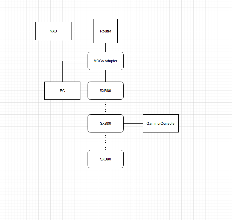

My network toplogy:
solid lines are physical media, dashed lines are wireless
firmware is 4.20.122
