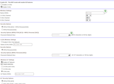

What channel configurations are currently set on the router?Has a power off for 1 minute then back ON with the ISP modem and router been performed since last update?

What channel configurations are currently set on the router?Has a power off for 1 minute then back ON with the ISP modem and router been performed since last update? No, but note from original post that the TV connects to the base Xfinity router(and modem) without issue.
