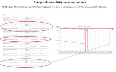

I am hoping someone can help. My Xfinity internet intermittently completely drops out, on both ethernet connections and Wifi, on avg, about 2-3 times per hour. However it will sometimes go a few hours without it happening at all. When it is stable, it works great (great down/up speeds, ping time, no latency, no packet loss). But when it drops, it completely drops. I am typically alerted due to either being on a zoom call and it losing connection or my nest cameral will send an alert that it lost connection. Once connection is lost, it reconnects almost immediately.
I have done all of the following troubleshooting. I am using a  Netgear Nighthawk CAX80 Modem/Router with my main computer directly wired to the modem.
1) Replaced Modem with a new modem
2) Replaced all ethernet cables
3) Replaced access points (2)
4) Tried on multiple computers
5) Replaced cable that goes from Xfinity box on side of my house to the Modem
6) Ensured modem firmware was up to date
Currently on firmware v5.1.1.8
I have run a network stability monitor to track stability over time and it identified the spikes with the internet outages.  I have reviewed the Modem logs and I have identified a pattern where the modem logs a "(DOS attack) ACK scan" every time an outage occurs, with the inbound IP address changing fairly frequently (not coming from the same IP every time) (see screen shot below). I have researched that specific log entry and the consensus is, if it were a typical DOS attack, it wouldnt say "scan" and it would be ongoing, not just once every 30 minutes. In addition, all the Nighthawk forums say they are more than likely "false positives" where the modem identifies certain activity as a DOS, when it really is normal activity from certain websites or services.
I am completely out of ideas on how to resolve, any other thoughts or direction would be greatly appreciated. Thanks
  • As a follow up and to close out this thread in case anyone else has similar issues, we finally identified the root cause and resolved the issue. The coax line from the cable provider (comcast) that goes from a box in my neighbors yard to my house was bad and needed to be replaced (which required running it underground). Once replaced all of the issues identified in this thread were resolved.
    Thanks for your help!

      DescriptionCountLast OccurrenceTargetSource
      [DHCP IP: 192.168.1.48] to MAC address 44:67:55:26:c8:d82Fri Mar 28 19:19:59 2025192.168.1.48:00.0.0.0:0
      [login] from source 192.168.1.921Fri Mar 28 19:18:02 2025192.168.1.1:80192.168.1.92:53375
      [DHCP IP: 192.168.1.48] to MAC address 44:67:55:26:c8:d81Fri Mar 28 19:17:59 2025192.168.1.48:00.0.0.0:0
      [DHCP IP: 192.168.1.216] to MAC address 18:b4:30:69:c7:e71Fri Mar 28 19:17:56 2025192.168.1.216:00.0.0.0:0
      [DoS attack] ACK scan SPT:443 DPT:389483Fri Mar 28 19:17:53 202576.154.153.101:3894835.212.178.254:443
      [DHCP IP: 192.168.1.196] to MAC address 82:a0:e8:6b:42:d91Fri Mar 28 19:17:46 2025192.168.1.196:00.0.0.0:0
      [WLAN access rejected: incorrect security] from MAC 18:b4:30:69:c7:e71Fri Mar 28 19:17:28 20250.0.0.0:00.0.0.0:0
      [DHCP IP: 192.168.1.53] to MAC address d0:3f:27:b7:e8:431Fri Mar 28 19:17:06 2025192.168.1.53:00.0.0.0:0
      [DHCP IP: 192.168.1.48] to MAC address 44:67:55:26:c8:d82Fri Mar 28 19:16:59 2025192.168.1.48:00.0.0.0:0
      [DHCP IP: 192.168.1.68] to MAC address e8:9f:80:39:21:f21Fri Mar 28 19:15:57 2025192.168.1.68:00.0.0.0:0
      [DHCP IP: 192.168.1.187] to MAC address 80:0c:f9:c1:0c:011Fri Mar 28 19:15:37 2025192.168.1.187:00.0.0.0:0
      [DHCP IP: 192.168.1.48] to MAC address 44:67:55:26:c8:d81Fri Mar 28 19:14:59 2025192.168.1.48:00.0.0.0:0
      [DHCP IP: 192.168.1.176] to MAC address 44:bb:3b:04:e7:501Fri Mar 28 19:14:57 2025192.168.1.176:00.0.0.0:0
      [DoS attack] ACK scan SPT:5223 DPT:531092Fri Mar 28 19:14:50 202576.154.153.101:5310917.57.144.102:5223
      [DHCP IP: 192.168.1.13] to MAC address 60:38:e0:ea:f3:d11Fri Mar 28 19:14:37 2025192.168.1.13:00.0.0.0:0
      [DHCP IP: 192.168.1.48] to MAC address 44:67:55:26:c8:d81Fri Mar 28 19:13:59 2025192.168.1.48:00.0.0.0:0
      [DHCP IP: 192.168.1.127] to MAC address 58:ef:68:dc:91:dd1Fri Mar 28 19:13:57 2025192.168.1.127:00.0.0.0:0
      [DHCP IP: 192.168.1.107] to MAC address 64:16:66:40:21:cb2Fri Mar 28 19:13:21 2025192.168.1.107:00.0.0.0:0
      [DHCP IP: 192.168.1.48] to MAC address 44:67:55:26:c8:d81Fri Mar 28 19:12:59 2025192.168.1.48:00.0.0.0:0
      [DHCP IP: 192.168.1.189] to MAC address 70:bc:10:65:9b:b61Fri Mar 28 19:12:23 2025192.168.1.189:00.0.0.0:0
      [DHCP IP: 192.168.1.216] to MAC address 18:b4:30:69:c7:e71Fri Mar 28 19:12:20 2025192.168.1.216:00.0.0.0:0
      [DHCP IP: 192.168.1.102] to MAC address d8:28:c9:8a:57:441Fri Mar 28 19:12:09 2025192.168.1.102:00.0.0.0:0
      [DHCP IP: 192.168.1.48] to MAC address 44:67:55:26:c8:d81Fri Mar 28 19:11:58 2025192.168.1.48:00.0.0.0:0
      [WLAN access rejected: incorrect security] from MAC 18:b4:30:69:c7:e71Fri Mar 28 19:11:55 20250.0.0.0:00.0.0.0:0
      [DHCP IP: 192.168.1.145] to MAC address 98:17:3c:0b:03:bc1Fri Mar 28 19:11:08 2025192.168.1.145:00.0.0.0:0
      [DHCP IP: 192.168.1.212] to MAC address 60:38:e0:49:8d:411Fri Mar 28 19:11:05 2025192.168.1.212:00.0.0.0:0
      [DHCP IP: 192.168.1.219] to MAC address 14:91:82:49:6b:fd1Fri Mar 28 19:11:02 2025192.168.1.219:00.0.0.0:0
      [DHCP IP: 192.168.1.48] to MAC address 44:67:55:26:c8:d81Fri Mar 28 19:10:58 2025192.168.1.48:00.0.0.0:0
      [DHCP IP: 192.168.1.134] to MAC address 78:28:ca:31:67:2c1Fri Mar 28 19:10:56 2025192.168.1.134:00.0.0.0:0
      [DHCP IP: 192.168.1.71] to MAC address 60:38:e0:46:9a:351Fri Mar 28 19:10:30 2025192.168.1.71:00.0.0.0:0
      [DHCP IP: 192.168.1.48] to MAC address 44:67:55:26:c8:d81Fri Mar 28 19:09:58 2025192.168.1.48:00.0.0.0:0
      [DHCP IP: 192.168.1.216] to MAC address 18:b4:30:69:c7:e71Fri Mar 28 19:09:43 2025192.168.1.216:00.0.0.0:0
      [DHCP IP: 192.168.1.127] to MAC address 58:ef:68:dc:91:dd1Fri Mar 28 19:09:39 2025192.168.1.127:00.0.0.0:0
      [WLAN access rejected: incorrect security] from MAC 18:b4:30:69:c7:e71Fri Mar 28 19:09:15 20250.0.0.0:00.0.0.0:0
      [DHCP IP: 192.168.1.48] to MAC address 44:67:55:26:c8:d81Fri Mar 28 19:08:58 2025192.168.1.48:00.0.0.0:0
      [DHCP IP: 192.168.1.27] to MAC address d0:03:df:b5:2a:881Fri Mar 28 19:08:20 2025192.168.1.27:00.0.0.0:0
      [DHCP IP: 192.168.1.48] to MAC address 44:67:55:26:c8:d82Fri Mar 28 19:07:58 2025192.168.1.48:00.0.0.0:0
      [DHCP IP: 192.168.1.19] to MAC address ca:6a:10:23:36:9c1Fri Mar 28 19:06:16 2025192.168.1.19:00.0.0.0:0
      [DHCP IP: 192.168.1.216] to MAC address 18:b4:30:69:c7:e71Fri Mar 28 19:06:07 2025192.168.1.216:00.0.0.0:0
      [DHCP IP: 192.168.1.48] to MAC address 44:67:55:26:c8:d81Fri Mar 28 19:05:58 2025192.168.1.48:00.0.0.0:0
      [WLAN access rejected: incorrect security] from MAC 18:b4:30:69:c7:e71Fri Mar 28 19:05:38 20250.0.0.0:00.0.0.0:0
      [DHCP IP: 192.168.1.48] to MAC address 44:67:55:26:c8:d82Fri Mar 28 19:04:58 2025192.168.1.48:00.0.0.0:0
      [DHCP IP: 192.168.1.216] to MAC address 18:b4:30:69:c7:e71Fri Mar 28 19:03:30 2025192.168.1.216:00.0.0.0:0
      [DHCP IP: 192.168.1.105] to MAC address 50:c7:bf:03:e8:791Fri Mar 28 19:03:07 2025192.168.1.105:00.0.0.0:0
      [WLAN access rejected: incorrect security] from MAC 18:b4:30:69:c7:e71Fri Mar 28 19:03:02 20250.0.0.0:00.0.0.0:0
      [DHCP IP: 192.168.1.48] to MAC address 44:67:55:26:c8:d82Fri Mar 28 19:02:58 2025192.168.1.48:00.0.0.0:0
      [WLAN access rejected: incorrect security] from MAC 90:48:6c:1c:6f:cc1Fri Mar 28 19:01:13 20250.0.0.0:00.0.0.0:0
      [DHCP IP: 192.168.1.154] to MAC address 90:48:6c:1c:6f:cc1Fri Mar 28 19:01:13 2025192.168.1.154:00.0.0.0:0
      [DHCP IP: 192.168.1.145] to MAC address 98:17:3c:0b:03:bc1Fri Mar 28 19:01:09 2025192.168.1.145:00.0.0.0:0
      [DHCP IP: 192.168.1.48] to MAC address 44:67:55:26:c8:d81Fri Mar 28 19:00:58 2025192.168.1.48:00.0.0.0:0
      [DHCP IP: 192.168.1.216] to MAC address 18:b4:30:69:c7:e71Fri Mar 28 19:00:53 2025192.168.1.216:00.0.0.0:0
      [DHCP IP: 192.168.1.154] to MAC address 90:48:6c:1c:6f:cc1Fri Mar 28 19:00:51 2025192.168.1.154:00.0.0.0:0
      [WLAN access rejected: incorrect security] from MAC 18:b4:30:69:c7:e71Fri Mar 28 19:00:25 20250.0.0.0:00.0.0.0:0
      [DHCP IP: 192.168.1.48] to MAC address 44:67:55:26:c8:d81Fri Mar 28 18:59:58 2025192.168.1.48:00.0.0.0:0
      [DoS attack] ACK scan SPT:443 DPT:371322Fri Mar 28 18:59:15 202576.154.153.101:3713252.37.185.175:443
      [DHCP IP: 192.168.1.48] to MAC address 44:67:55:26:c8:d81Fri Mar 28 18:58:58 2025192.168.1.48:00.0.0.0:0
      [DHCP IP: 192.168.1.127] to MAC address 58:ef:68:dc:91:dd1Fri Mar 28 18:58:51 2025192.168.1.127:00.0.0.0:0
      [DHCP IP: 192.168.1.216] to MAC address 18:b4:30:69:c7:e71Fri Mar 28 18:58:11 2025192.168.1.216:00.0.0.0:0
      [DHCP IP: 192.168.1.48] to MAC address 44:67:55:26:c8:d81Fri Mar 28 18:57:58 2025192.168.1.48:00.0.0.0:0
      [WLAN access rejected: incorrect security] from MAC 18:b4:30:69:c7:e71Fri Mar 28 18:57:42 20250.0.0.0:00.0.0.0:0
      [DHCP IP: 192.168.1.216] to MAC address 18:b4:30:69:c7:e71Fri Mar 28 18:57:37 2025192.168.1.216:00.0.0.0:0
      [DHCP IP: 192.168.1.48] to MAC address 44:67:55:26:c8:d81Fri Mar 28 18:56:58 2025192.168.1.48:00.0.0.0:0
      [DoS attack] ACK scan SPT:8883 DPT:648582Fri Mar 28 18:56:16 202576.154.153.101:6485840.112.221.115:8883
