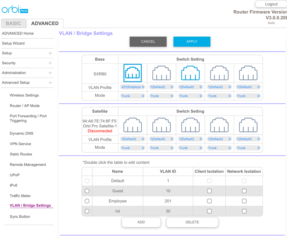

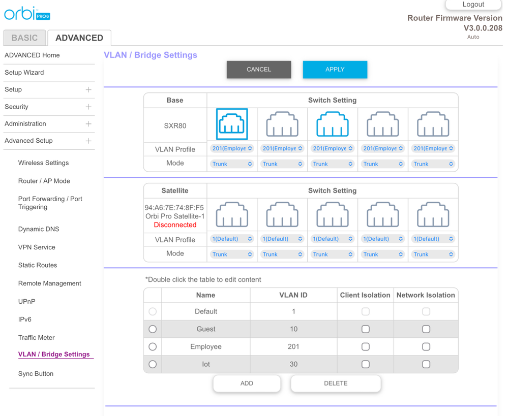

  • Well I was able to get Internet access via Wireless 1 or 2 (note didn't select the VLAN box on any of the wireless settings).  I set the employee VLAN to 201 under the advanced menu and assigned to far left port.
    I CAN'T get Internet access on any of the router's wired ports.  I tried setting all the wired ports to employee (201) or default (1) and in both cases no Internet on wired ports.

    Neither of these settings allowed the wired ports to have Internet access:
