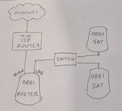

Hi Schumaku, thank you for your help.
I attach an image, please confirm that it is what you suggest. I will have problems in moving the satellites but I will try.
Yes, this is the idea I had in mind.
Of course, you can also connect the satellites direct to the Router LAN ports direct.
