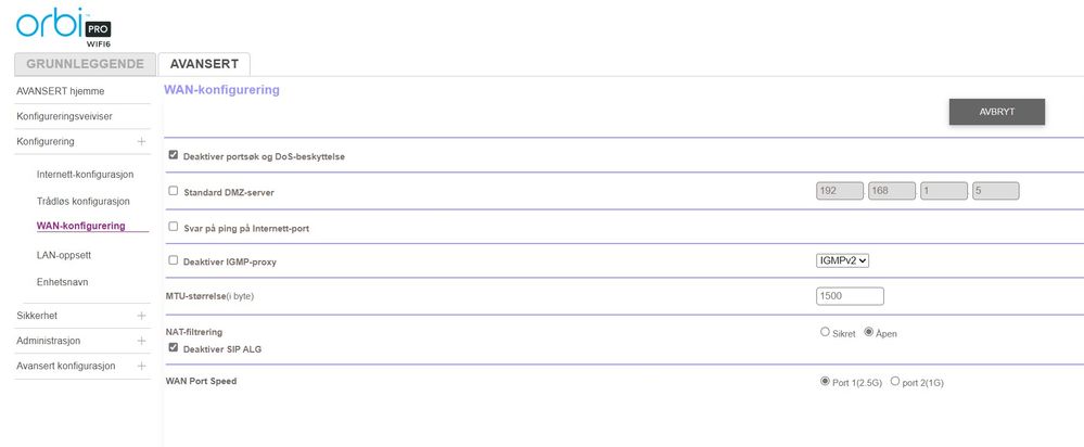

We experience problems with IPTV provided from Telenor, wich is a Norwegian ISP which also delivers IPTV via a box connected to internet.
The TV box is connected to a Orbi satallite with cable. The satallite is connected to router with cable via a switch. The TV works, but falls out quite often (mayby every 5-10 minutes). It often comes back after a few minutes, or we can restart the TV box.
If we stream TV with for example Netflix, there are no problems. Internet signal is stable and fast (500 mbit/s).
Telenor has provided a new box, but the problem remains. I think the problem is with router or router settings. I have read other similar posts, and the problem has been solved by a firmware update from Netgear.
Below you can see our current settings.
I hope someone has the same problem with a sollution. Thank you in advance.

    Maximum confusion for me now, as there is no NAT configuration similar to the older Nighthawk routers, allowing to configure a dedicated IPTV LAN there. Definitively need Netgear assistance here please (considering the community know-how tells us there is no IGMP snooping available on the Orbi systems.  8-/
    BruceGuo and hnagaraju please - certainly on the Orbi Pro implementation side at least.

      Curiosity question: Is the TV box connected to the SXR80 router on a LAN port (and on the default VLAN 1) or on the SXS80?
      • ThomasNorway's avatar
        ThomasNorway
        Hi
        The TV box is connected to SXS with LAN cable. Both SXS are connected to SXR with LAN cable.
