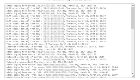

Orbi SXS80 Magenta light stays on even with connected internet
Recently I noticed that the status light magenta stays solid on my Orbi Satellite SXS80. I checked and there are devices connected to it that have access to the internet. In the logs it is showing th...

- TechdeskxyMar 28, 2024Aspirant
Yes, I had seen that before but it was not the case because the devices still had internet connection even though the Orbi was giving a magenta light.
I was able to resolve, allowing ICMP ping to my home network. I guess the Orbi pings the network to check on the status of the connection. It was previously disabled for security reasons.
