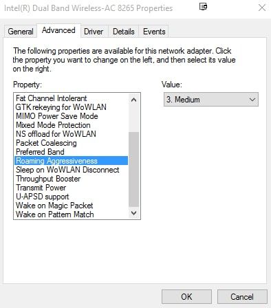

Just to add with what askvictor mentioned, here below is a sample screenshot where you can check the Roaming Aggressiveness on the setting of the WLAN adapter of your laptop:
The value set to "Medium" as shown above is usually the default setting.
