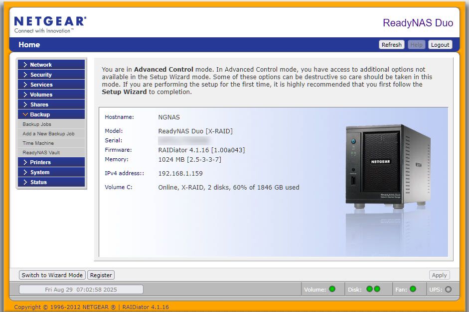

My Ready Nas is a Duo V1. See pics below.  I'm using FF 142.0.1 (but this issue has been going on for a while now.  My Duo has the "fix" for the cipher error.

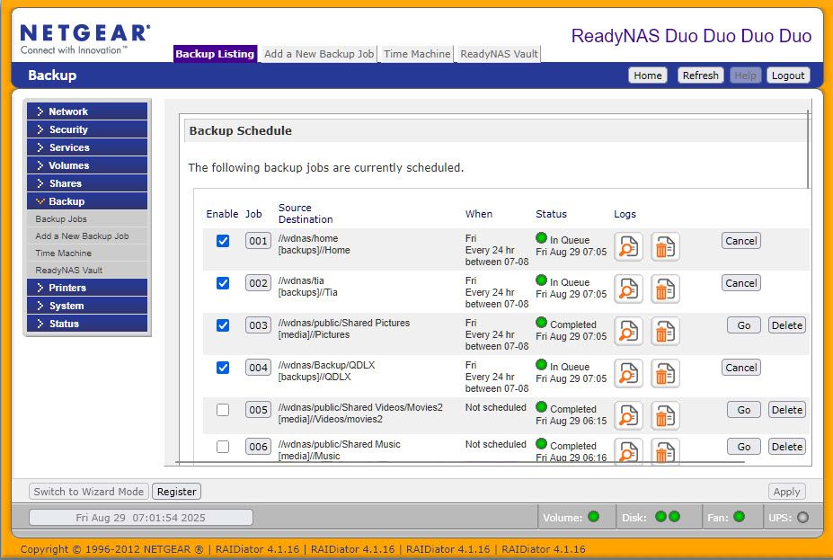

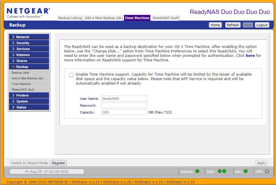

Launch FF and go to my Duo login page, login and all looks OK.  Expand the nav bar to access Backup, select Backup Jobs.  The menu will collapse (not go into Backups) and the Home banner will have an extra Duo (ReadyNAS Duo Duo).  If I repeat the same steps, same result but I'll have 2 extra Duo's (ReadyNAS Duo Duo Duo).  Yet, If I select Time Machine instead, Time Machine page will open OK.  If I use the tabs to go to Backup Jobs, then Backup Jobs open OK.  I can then view logs etc.
This behavior is not limited to Backup.  Generally any of the main sections, like Network behave in similar fashion.  If I select Network Interfaces, I get another Duo.  If I select Global Settings, it opens OK and I can select Interfaces from the Tab and get in OK.

Screen when I login.

    After Selecting Backup Jobs. Menu closes and have double Duo.
    Can get to Time machine (note I tried a few more times so you can see many Duos)
    Then use the Tab to get to Backup Listings. (note jobs are running).   Once here, I can access the logs, job properties, cancel, etc,
