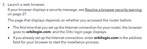

p.p.s. I may have been incorrect in recommending http://orbilogin.net . I see on page 25 of the user manual that Netgear describes the connection as http://orbilogin.com (can three little letters really be the problem?)
Information about these browser errors is on page 27:
https://www.downloads.netgear.com/files/GDC/SRK60/SRK60_UM_EN.pdf
