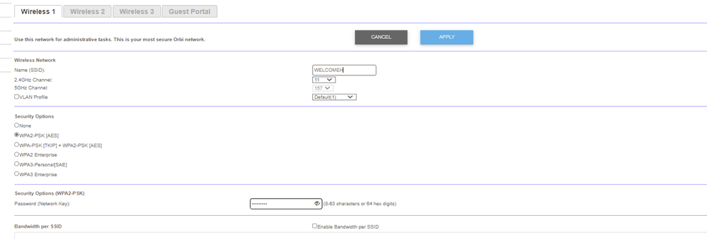

We are not in a daisey chain. They are wired, ROUTER ---> SWITCH ---> AP1, same for AP2 when it was turned on. I would expect that would take the backhaul out of the equation. Also in these models I have not found any way to change the 5ghz channel.
The drop down for the 5Ghz is grayed out.

- MCioffiMar 10, 2022Guide
Don't know why the pic was not approved.
But here is a snippet of what I see.
