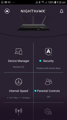

      I agree with michaelkenward when he says that netgear has turns on the free one-month trial of armor and they're trying to suck me into a subscription. Here's a problem with that: I cannot get into SECURITY within the nighthawk app. It wants me to activate the trial, and I do not want to do that. I bought the router as an alternate for the router given to me by SPECTRUM mainly because i needed 2.4 and 5.0 connectivity, and I wasn't getting that from my SPECTRUM router. I do not, under any circumstances, want security protection from netgear. I have McAfee for that. Quite frankly, I find it appalling that Netgear is offering a 'free trial' and subsequently would want $100 per year.

      I think the best solution here would be to follow schumaku 's suggestion to turn off armor. However, when I go to SETTINGS ---> SECURITY, it wants me to activate the trial, and if i try to activate the trial,  I get a message "Error. Failed to subscribe.  SECURITY. Activation Failed. We could not activate NETGEAR ARMOR on your router. Try again", but of course, trying again gives me the same results.

        If you can get in with that, you will be able to see if Armor is enabled.
        As schumaku says, a screen shot of the message/error would help.
