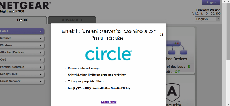

R7000 NightHawk How To Dismiss Circle Blurb?
Hi - How can we remove the intrusive blurb every time we sign in to our router?
CIRCLE - Enable Smart Parental Controls on Your Router
We don't have need it or want it. It seems to have appeared with the latest firmware update.
FINALLY -- THE SOLUTION APPEARED
Just to upgrade the firmware to V1.0.11.116_10.2.100, and the blurb is gone.
I did so, and it works. Negear's information follows:
Bug Fixes:
- Fixes possible system kernel panic issues.
- Fixes the issue where the attached device list displays incorrectly.
- Fixes the issue where the Circle ad window displays every time when logging in to web interface.
Download Link: https://www.downloads.netgear.com/files/GDC/R7000/R7000-V1.0.11.116_10.2.100.zip

- Sonya808Tutor
Thank you, Christian, for replying - The firmware is V1.0.11.110_2.1.38.1 . The blurb appeared with the latest firmware update. I contacted Mozilla support for Circle about removal. They ignored my question. I scoured the web. Some people advised to roll back to original factory defaults. That seems self-defeating. The firmware updates are for a good purpose.

- Sonya808Tutor
Bug Fixes:
