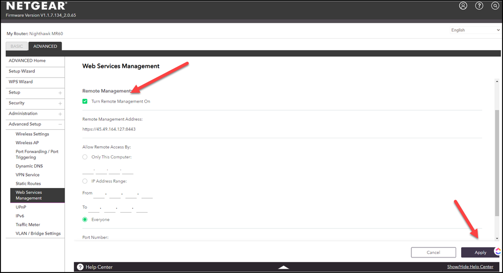

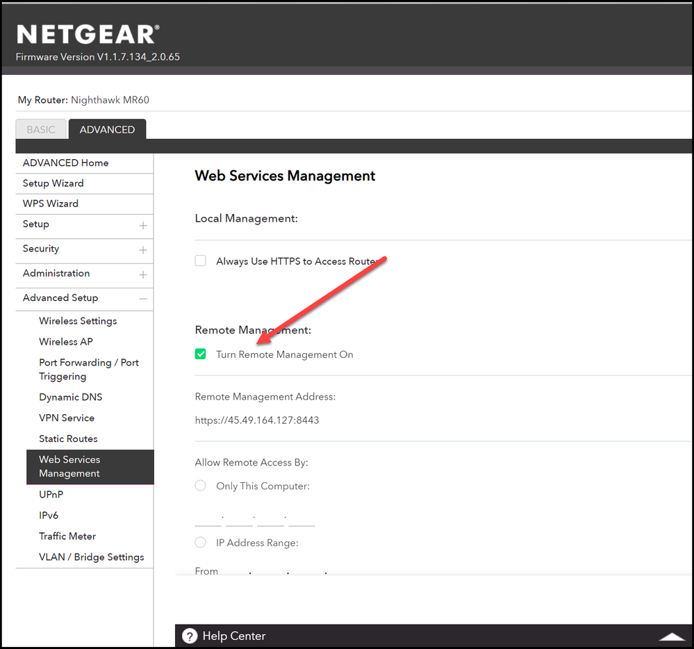

If anyone can help I appreciate it. I have the latest firmware. I am just trying to turn off the Remove Management.
When I unselect and then hit Apply it does not save the setting, and turns it back on... Anyone have any suggestions? I have to get it turned off to pass a PCI compliance test. Thanks!

It's so odd I can deselect the option, but when I go to save, it turns it back on.
