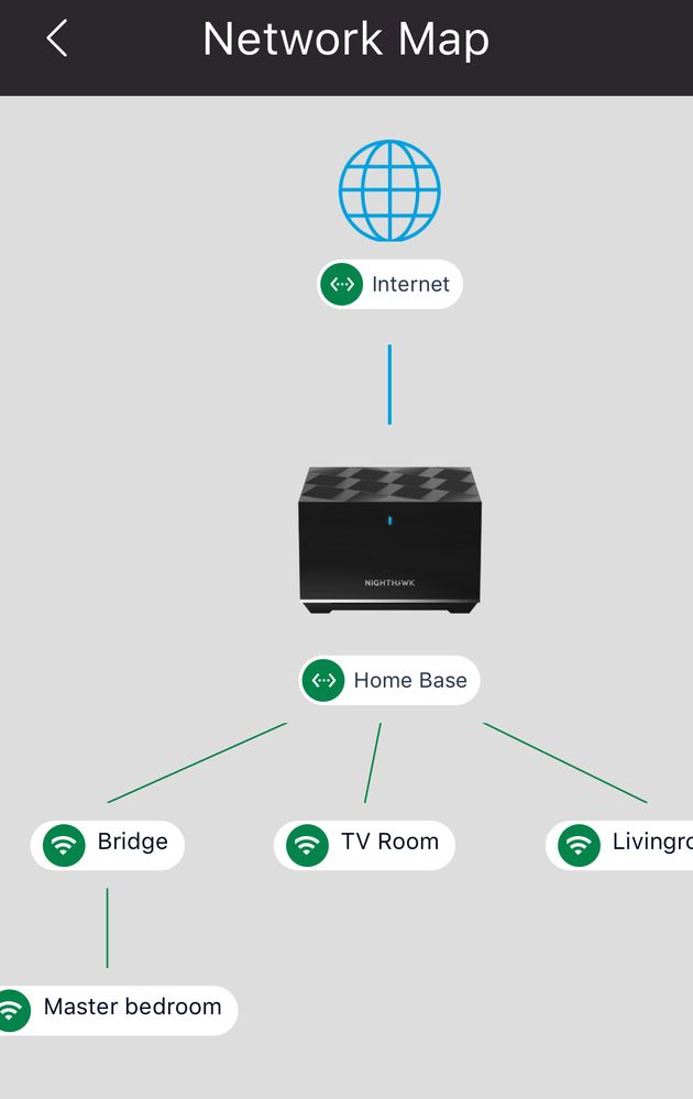

I also have two MS60s hanging off of it, all are working as expected, I.E. connectivity.

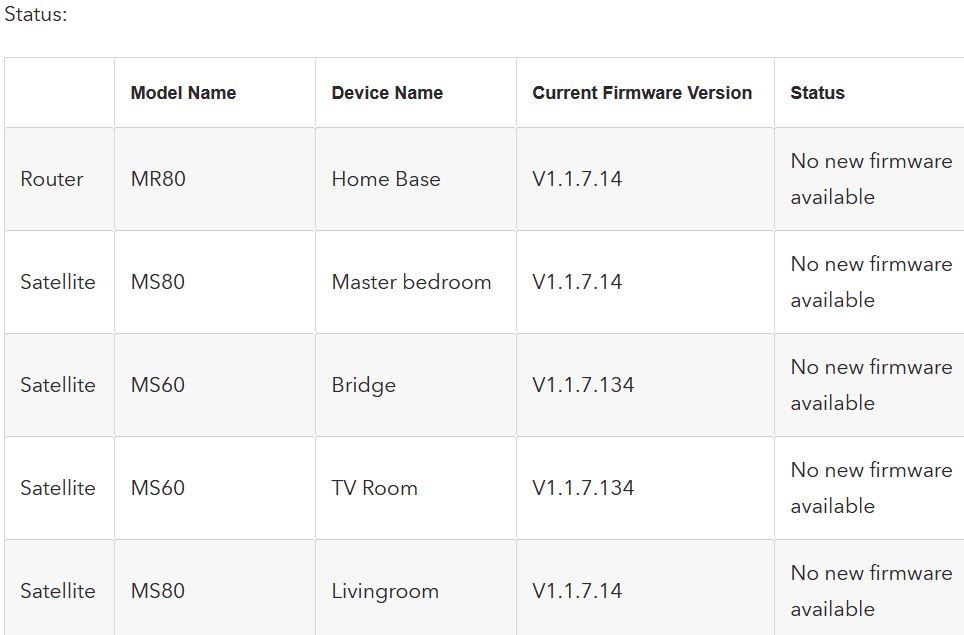

As you can see I'm using the latest firmware and I don't feel I have too many devices connected to cause this to reset like this.

    How big is your home?
    That seems like a lot of satellites.
    what happens if you power a few of the satellites down?
    I know they added compatibility with one of the firmware's for the MS60 and MR80 but later I'd seen a post that they'd removed those compatibilities. So try powering them off and seeing how it works. You might have to downgrade firmwares if you want to keep the compatibility.
      I have a medium-sized house, but my computer is less than 10 feet from the MR80, which I am hardwired directly into.
      The satellites never lose connectivity, it just seems that the MR80 crashes or resets for unknown reasons...
      The MR80 is in one corner of the house, where the cable enters, and the closest satellite is maybe 30 feet at most from the MR80. I get a good signal and throughput to all the satellites...
