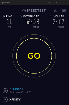

Very frustrated with this system.  I have browsed through the forums and nothing seems to help. Firmware is V1.1.7.132_2.0.64.
I have a Arris SB6190 cable modem through Xfinity.  Wired from the MR60 directly to my PC Ethernet I see speed in excess of 800 Mbps down and 24 up. (This is what I am paying for).  Connecting to one of the satellites MS60 wired Ethernet to my PC 500 Mbps. If I use 5ghz wifi (my adapter is a Intel ax200 Wifi6) I get 300Mpbs. I have used WiFi scanners to verify strong connections and no mixing with any neighbor channels. I have tried making a customized 5g network with no difference. I cannot put the MR60 in AP mode my modem is not a router.
I have powered off both MS60s and connected made sure I was connected directly to the MR60 less than 20ft from me.  No difference.

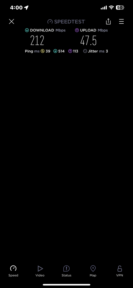

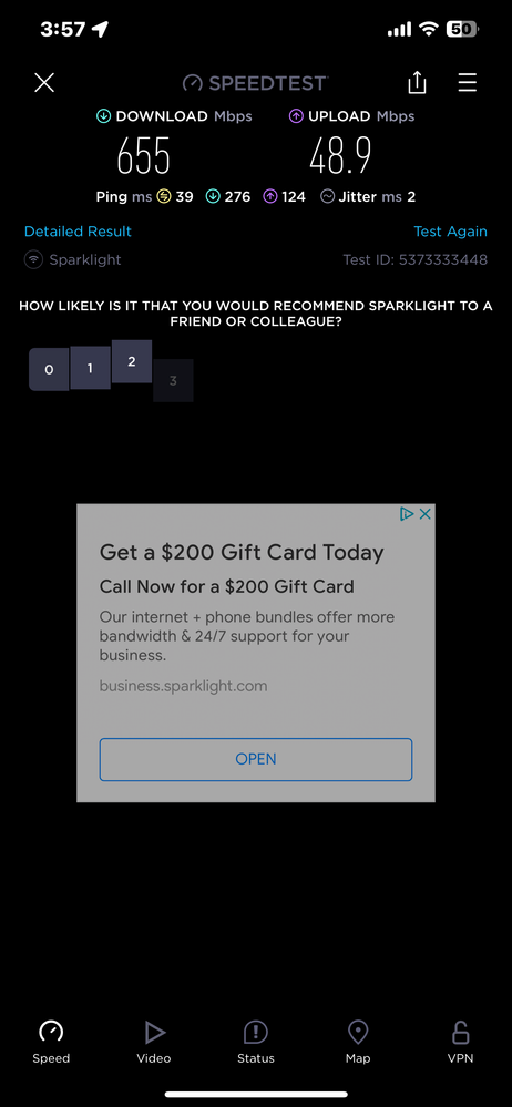

    What I see near my MR with my iPhone:
    This is good for this system.
    What I see at my MS:
    More then likely won't see much over this at the MS.

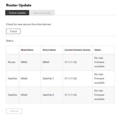

      I'd like to hope so. I can't even upgrade the devices manually.  I get a 404 Not Found error after I enter my credentials.  When I try to let the software search it doesn't give me the option of new firmware.
      • FURRYe38's avatar
        So can you try manually updating the MS first then MR lastly as described in the link given?
        You can log in to the MS web page and send the extracted .zip FW file on the MS web page using a PC and web browser.
