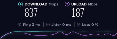

  • KaraBond wrote:
    Wired to the router I get:
    Ok so we know wired is GOOD.
