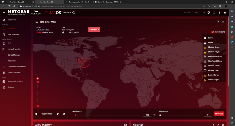

call of duty not filtered on geo filter for PC Xr1000
- Thanks for that, remove the PC from the Geo-Filter, then in the Device Manager change the PC to a PlayStation device type then re-add to the Geo-Filter and select the manual option then you should be able to filter.
23 Replies
- Netduma-FraserNetDuma PartnerI can't see the picture until it's been moderated, can you add it as an attachment please?
- Retired_MemberIt also happens to me it says that it's incompatible but it should be compatible
- Netduma-FraserNetDuma PartnerDo the above and it will definitely work for you
