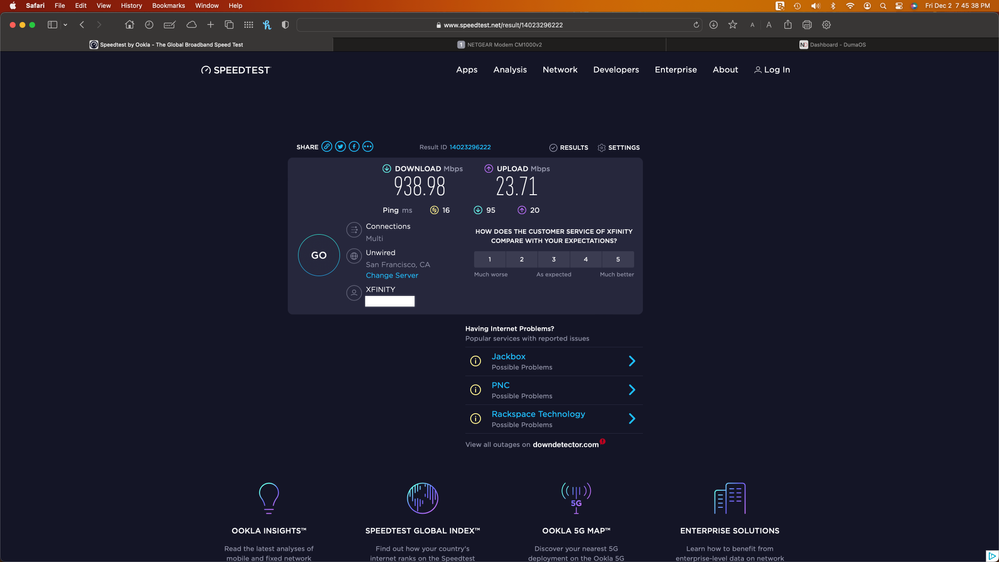

I have recently upgraded my home networking equipment from an Orbi RBR50 to the Nighthawk XR1000 Router. My speed test results are really fast when I connect my computer (2017 iMac) to my cable modem (Netgear CM1000 v2). I get into the 900 Mbps which is fine since my Xfinity internet plan allows for speeds up to 800 Mbps.

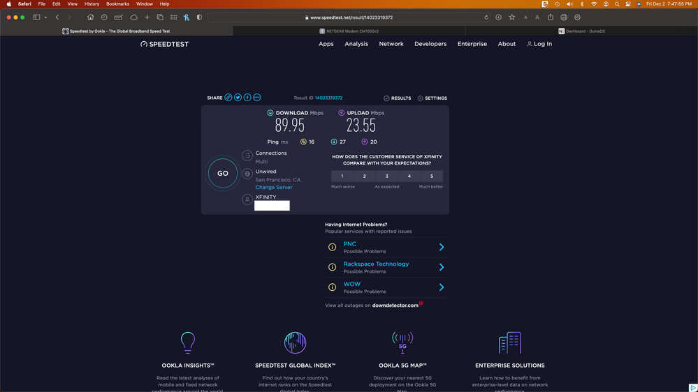

The problem is when I connect my computer to my router via LAN port, the speed test results drop dramatically into speeds that are less than 100 Mbps. My equipment is connected using Cat8 ethernet cables which is probably overkill for my setup but better than the Cat5e cables that are included with the equipment.
I have had several phone calls with Netgear Pro Support in which they have used zoho join to diagnose this particular issue. After downgrading the firmware (to solve a previous issue) I upgraded it to the current version and the first speed test I ran was satisfactory (> 900 Mbps). Then I ran a Connection Benchmark test within the DumaOS router admin tool and that gave my download speed test a letter grade of 'B'. Was expecting it to be an 'A' but oh well. I then ran another speed test and once again my download speeds reverted to < 100 Mbps.

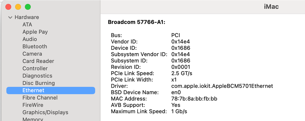

    And this computer is? What is the LAN chip?
    Whenever someone reports 100 Mbps, the first thing to check is that the LAN ports on the connected device are gigabit, rather than the older 100 Mbps. Some devices, such as smart TVs and media devices, still come with 100 Mbps because that is fast enough.
    This isn't likely to be the case with a PC, but who knows? Hard to tell without more details.

      -  And this computer is? What is the LAN chip?
      The computer I'm using is a 2017 iMac and I attached the ethernet specs in a screenshot.

        Can you provide an attached screenshot of the table view on Device Manager please?
