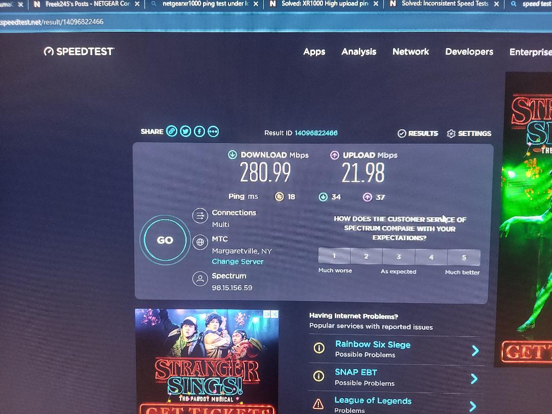

I recently purchased the xr1000 gaming router because I thought that was the issue I was having with my connection while playing games on my pc was my old router. While this router has a TON more features than my old one, I am able to try and narrow somethings down. I am not the most tech savvy person and this has been a process for me, but I need someone to help me out, and I'm starting to lean towards it being on my ISP end. After every time I do mess with it though and do a connection test it's the same result, good speed, good ping but horrible Ping under load and I have attached some pics of tests I have done. Also, when I do the test, it says my internet is 540ish download when all I have is 300 so whatever that's about.

- Netduma-FraserNetDuma PartnerThe router won't affect the in game location that will be down to your ISP and the routing they're putting you on - this will likely resolve itself after a certain amount of time as long as the modem isn't rebooted. What is the model of the modem/router the XR is connected to? Your Ping Test has quite a lot of spikes and that is to do with the ISP. Ping Under Load can be resolved by experimenting with Congestion Control percentages while set to Always, although it will only be as good as the Ping Test which is a baseline test of your connection.
- Freek245Aspirant
Ok, yea like I said I'm not too much of a tech person and i figured that the ISP was responsible for the location just thought I'd add it to see if anyone thought it was weird and to help with my case that it is an ISP issue. So the modem is a ARRIS TM1602A and my provider is Spectrum and they are the wooooorrrssst. I did mess with the congestion control a little bit and seemed like the less I made the percentage the worse the ping got but i will run a few tests again at different percentages and share my results, thank you. I also did a speed test with ookla I will share results in case that helps (or doesn't), thanks again
- Freek245Aspirant
- Netduma-FraserNetDuma PartnerThat will be down to the ISP then I think, it's hard to determine what can be resolved with QoS when the baseline is that unstable. The Connection Benchmark test uses the Google servers for the Ping tests so it's possible your connection to these tests isn't very good. Follow this guide and use a local website and lets see what baseline you get that way and we can proceed from there https://support.netduma.com/en/support/solutions/articles/16000074717-how-to-test-your-internet-ping
