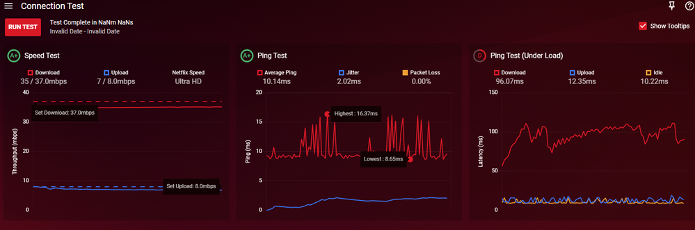

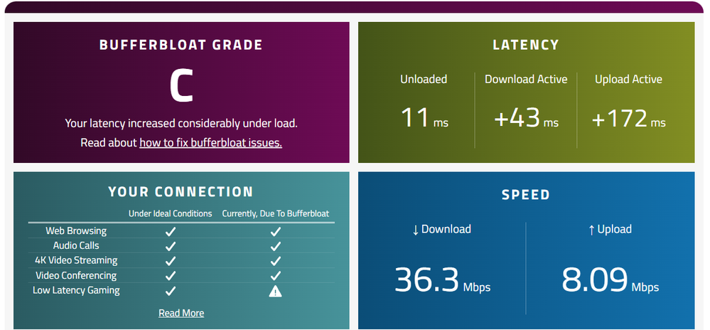

I'm hoping someone can help/point me in the right direction. For about a month now, I've been receiving high upload ping, whilst underload. My hit registration in-game has been really poor in this time - this is what prompted me to undertake the tests in the first place. Prior to this my upload ping was around 3ms. Initially I thought the issue lay with my ISP but after undertaking a few tests I'm not so sure.
The test result attached (waveform.png) is pretty much identical results to what I have been receiving over the last month. In the last month I changed ISPs and admittedly my overall in-game has dropped from 20ms to 14-15ms. But my upload ping has not changed. I appreciate the issue could lay with Open Reach but trying to diagnose as much I can my end before escalating.

Firstly, when I undertake a Connection Benchmark within DumaOS, the Ping Test - Underload actually shows the issue being with my Download and not my Upload - which I thought was strange (DumaOS.png). Why was Waveform showing the issue with Upload and DumaOS showing the issue with Download.
I've been applying around with having the QOS disabled - no change to the upload ping and then applying the QOS. I have applied the QOS to my Download Only and the speed is reflective in the QOS applied i.e. 50% delivering a speed of approx 20MBPS. But when I apply to the Upload Only the speed is no different. To confirm, my QOS is set at 47% of my Upload and should show a speed of approx 3.8MBPS but as you can see from the waveform.png image, it isn't applying the QOS. This suggests to me, that the router is causing an issue with my Upload, as for some reason, it is having determining/separating it.

- In most cases like yours it'll be due to PPPoE, disable bridge mode on your ISP router, have it handle PPPoE instead, put the XR WAN IP in its DMZ instead then see if it works as expected

Unless anyone else has any suggestions, going to the ISP to run tests is the way forward. Just didn't know if it was a known issue due to weird upload/download test results I showed.
Show them the results since it's happening with there stuff. Once it's resolved there, then you should be good to go with the XR. Any router connected to a ISP modem depends on good signal at the modem.
