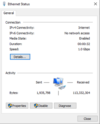

I tested my PS5 via CAT 5E on each port and I am getting 820-900 Mbps down and 110 Mbps up. I also tested a macbook wired and it was receiving around the same numbers as well. After contacting support about this problem, they asked to check my network connections settings and I verified that my ethernet network speed was showing 1 Gbps.

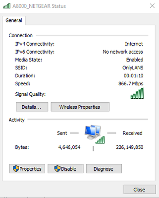

      This is what it looks like with the wifi adapter

      I set the bandwidth speeds to 1000 Mbps down and 200 Mbps up for recent test results. As for the link speeds on ports its showing 1000Mbits, Full duplex.
