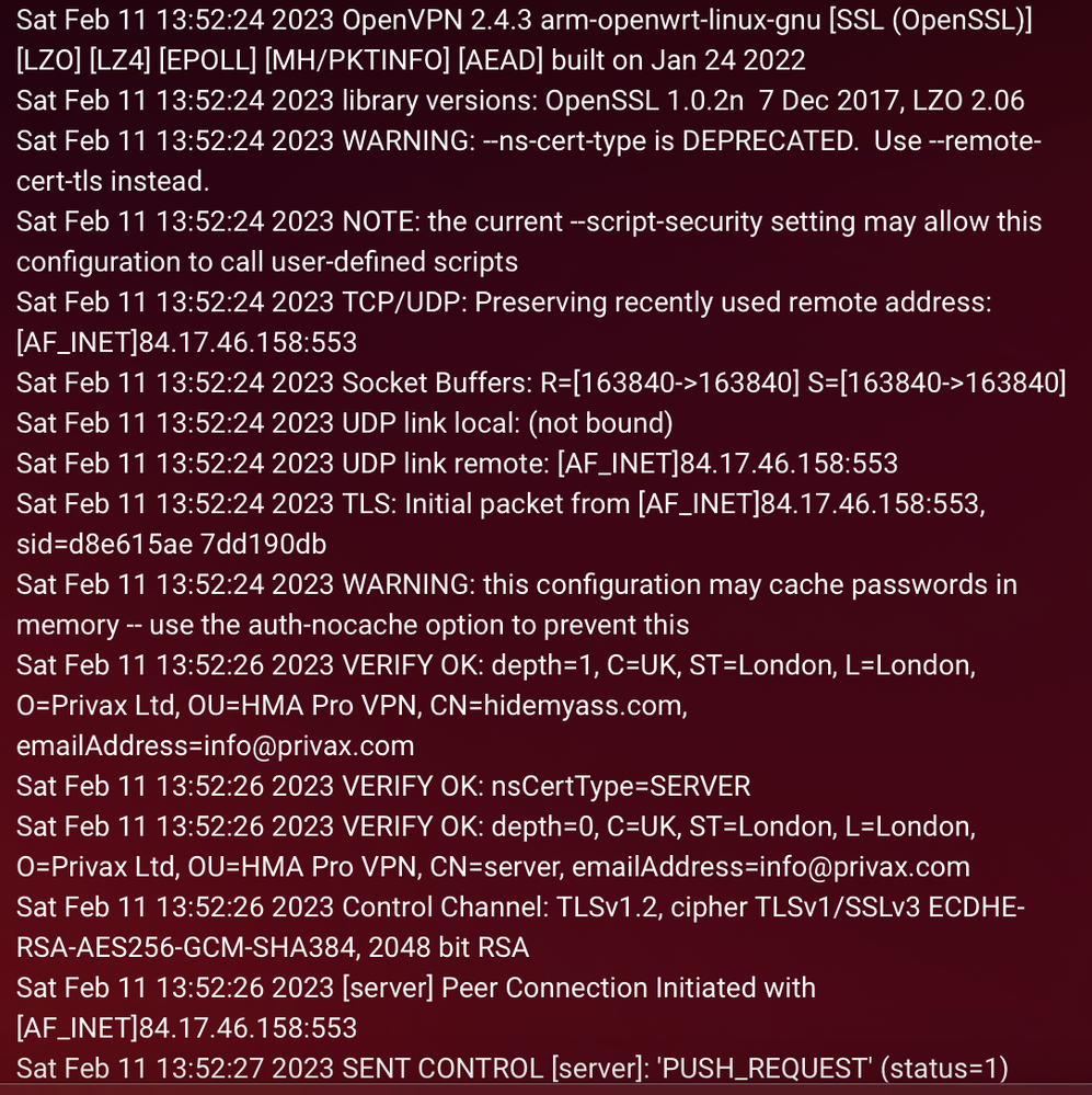

I have problem with vpn connection
nothing was done or changed. I went on holiday for 10 day then it just stop working.
router is XR500
vpn Hide My Ass
Can someone please help me solve this problem?

        The servers on file are out of date, you'll need to get the OpenVPN config files from HMA and then use it with the Advanced Setup instead of Basic Setup for the moment, then it will work.
