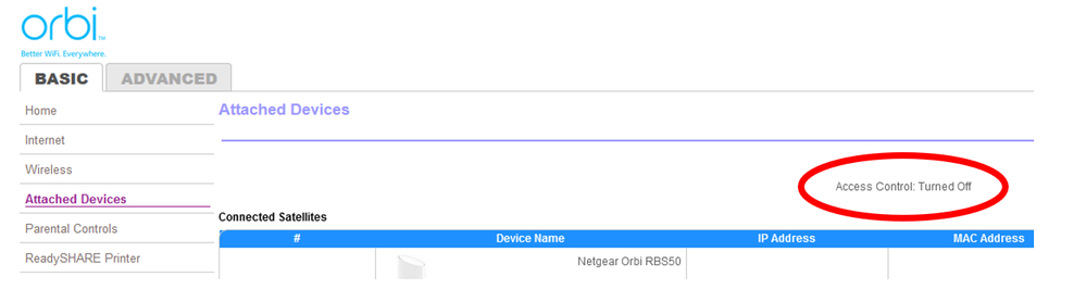

        Well, fudge.  My Orbi Attached Devices shows this:
        By any chance is Smart Parental Controls (SPC) enabled on this Orbi?
