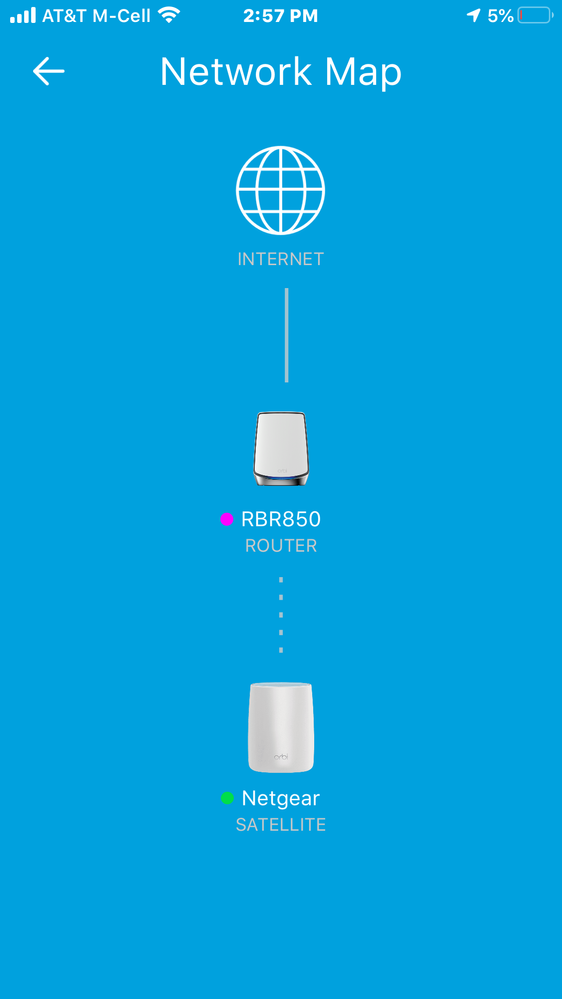

RBR852 - App started showing an additional satellite
This is a recent issue, the Orbi app is showing an additional satellite that does not exist using the RBR852 system. Rebooted, re-installed the app and still appears. I only have one satellite and my RBR850 is in router mode.
  • Finally solved the mystery satellite issue in my Orbi app. Had time to do a complete factory reset and set everything back up from scratch. I believe my back up config file imported something corrupt and caused the issue of the "satellite-2" showing that was never there.

      Firmware Version
      V3.2.15.25_1.3.15
      App Version
      2.5.4.1036

      I can confirm similar RBS AC icon on my Orib AX system with 1 RBS850 connected.
      v2.5.2.1\iOS 13.6

    I presume the RBRs web page only shows the one RBS connected in a web page?
    • KMDonlon's avatar
      KMDonlon
      Virtuoso
      Yup, web gui shows everything perfectly... Only the app shows the additional old style satellite.
      • KMDonlon's avatar
        KMDonlon
        Virtuoso
        Another user in the AX forum noticed and additional satellite showing in his system as well (RBR853)
        There is definitely a "bug" somewhere
