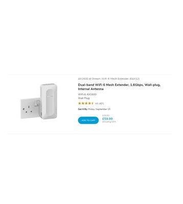

      So as I'm still looking to add extra coverage to my network would this product be any good ? (image attached below)
      As i say i am running a Wi-Fi 6 Mesh system RBK353 AX1800.
      • CrimpOn's avatar
        CrimpOn
        Guru
        My answer is, "probably".
        • This product is clearly intended to connect to the Nighthawk line of WiFi routers.
          using both the Orbi and Nightawk apps could be annoying.
        • That talk of "smart roaming" is not likely to apply to non-Nighthawk products.
        • It is an indoor product designed to plug into a wall outlet, so window mounting would be awkward.
        I would definitely purchase from a vendor with a generous return policy.
