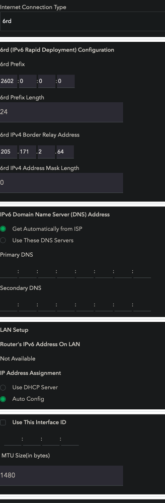

  • I have CL Fiber and have been through exactly what you describe many times. 6rd is the easiest and cheapest way to deploy "fakish" IPv6. And depending on what the area you are in was previously setup the settings and format may be different. But if you know that it's 6rd, you're a third of the way there. Even setting it up in their own routers is a bit of a job.
    There is a set group of settings that your dynamic IPv4 Address won't affect. It directs you directly to the IPv6 servers. You may already have it, but please find them attached. I use them on all my gear and depending on which Router System you're using they will behave differently. On my Orbi RBK853, IPv6 worked like a charm until a FW update halfway through v3.x. Since it's work for a while then nothing. On an MK-X3 system I have had it up and running for a long time. So . . .
