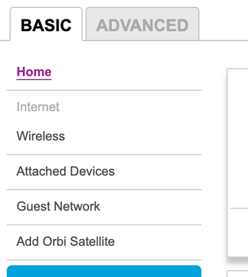

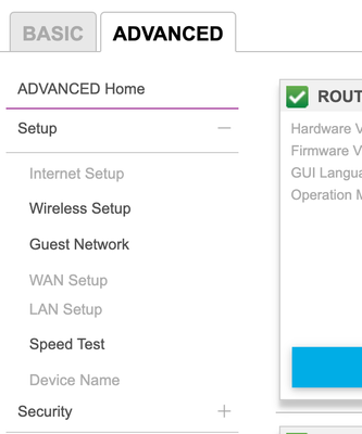

Can't change IP address for my RBR850..?
So my problem is that my Orbi RBR850 is only giving me speeds of 8/9mbps second, but I've come accross this solution to change my routers IP so that it does not conflict with my modem. However, when I log into orbilogin.net to do that, I'm not able to select the "internet" tab which I've read is the place to make that update, as it's grayed out and not clickable.
Would anyone be able to help me with this or point me in the right direction? It's been a long struggle to get this mesh system working proporly with my ATT Fiber service and hopefully this is the final step. Thanks in advance.

       Is your RBR850 configured as a wireless access point?  That would
    explain the grayed-out Internet settings.  It would also make some sense
    if your RBR850 is connected to some other router.
      Thanks, yes it is in AP mode. Would router mode unlock those setting or do I need to directly connect via ethernet cable?
      It would also make some sense if your RBR850 is connected to some other router. In that case, your external/public IP address would be controlled by your actual router ("my modem") and your ISP.
      Its connect to the NBS AT&T BGW-320 500. But wouldn't the IP Passthrough mode negate it as acting as a router? That was my understanding but could be very wrong.

      • FURRYe38's avatar
        IP Pass thru on the ISP modem is not needed nor recommended if you have the Orbi RBR in AP mode. If your in AP mode then there is no firewall present if your using IP pass thru on the modem. You can change the Orbi to router mode then continue to use IP Pass thru. Then you can also change the RBR IP addressing scheme as well.
        AP mode you can use either Dynamic IP addressing which the RBR in AP mode will get an IP address from the ISP Modem, OR, set a Static IP address while in AP mode ON the RBR, to some address that is outside of the ISP modems DHCP IP address pool, not with in the pool.
