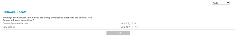

I have downgraded the two satellites successfully but when I come to do the router, the system will not let me rollback to an earlier FW version.Instead I get the below warning with no option to acknowledge it and continue.
This has now left me with two satellites on a dfferent, older FW to the router and no way to fix the issue that I can see. I have raised the issue with Support but have yet to hear back and I'm at my wit's end as this has left me with a useless mesh system.

Many thanks for your help, FURRYe38.
The link about using debug mode in Edge did indeed work - thank you for sharing it.
Downgrading the FW solved the issue but of course within an hour the router auto-updated the FW again. However support now tell me they have "elevated" the problem to a "higher tier". I imagine this means they will suggest I download the beta FW you have just mentioned.
